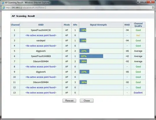

First I started looking for the right channel to use as there is much WiFi traffic at my location, I choose 13 because it looked like the one which is the least used one by looking at these results (my network is WLANGZX):
scanning result from inSSIDer 2.0
Large image>1<
scanning result from router
Large image>2<

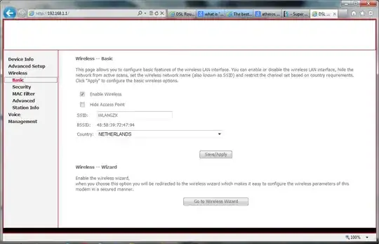

Here are settings from the routers webpage:
Changing the channel is not needed, right? I choose a good one?
(I do not have the 5Ghz band available :( )
And if I hide the SSID would the connection be better?
Does the encryption type matter in case of connection stability and for a long distance-connection?

I don't think you can use Channel 13, its made for Europe or something. Here's what you want to do:
Make a list on paper of all the networks, excluding the ones that are very weak.
Your basic channels are 1,6,11. Other channels overlap with each other.
If someone else uses channel 4, round it up to 6. Channel 3, round down to 1, and so on. Count all the numbers 1,6,11 people, then pick the lowest one, and choose that. This isn't scientific, I made it up just now.
