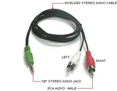

You can use a cable like this. PLug into your earphone jack on laptop and the RCA should go into AUX, Line IN on your Home Audio System.

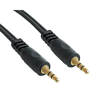

Sometimes your Home Audio System also uses a Jack as an Input so use this cable instead.

.. you will need the RCA plugs put into the TV/AV (cant read it to well) input. Then set it to TV so that it can play audio from your notebook.
