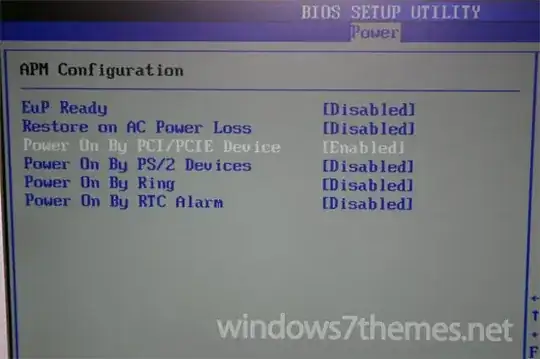

You should check if you have anything similar to this in your BIOS:
Setting everything to disabled at the "Power" tab should override any Windows settings.

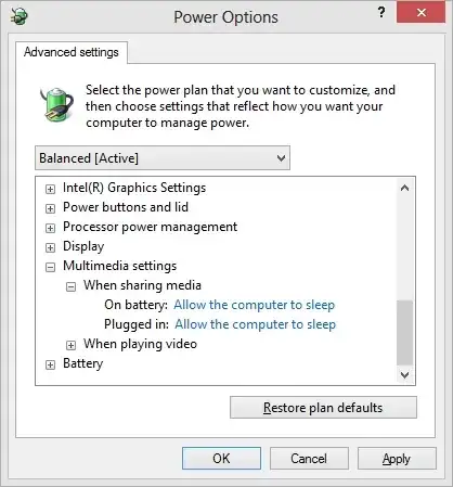

You can also disallow all wake-up timers in Power Options / Advanced settings / Sleep / Allow wake timers.

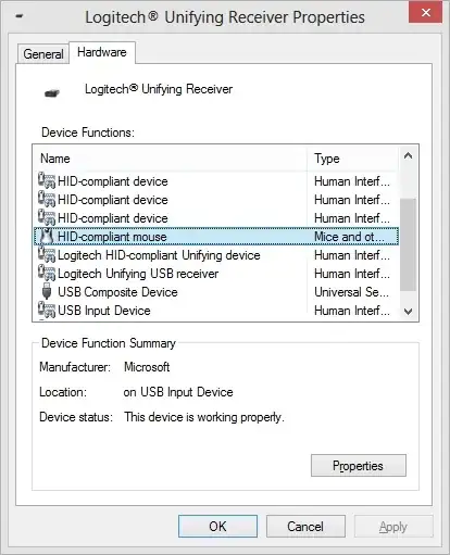

Sometimes there are several things in parallel behind a problem, which was my case. There were several things that woke my laptop at night occasionally. I had to alter all these:
  1. LAN-card, Wifi-card: Switch off network card "Allow this device to wake the computer"
  2. Logitech wireless mouse: Switch off "Allow this device to wake the computer"
  3. Mouse/keyboard in Logitech unifying controller "Allow this device to wake the computer"

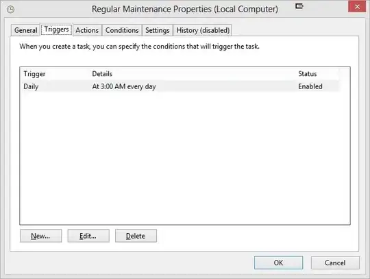

I changed the settings in the Network Card properties, Mouse properties, Time settings, Windows Backup. I also run command prompt: powercfg /waketimers.
Then I went through all the sub folders of in Task Scheduler, and modified all remaining tasks to run during weekdays, at lunch time or at dinner time. I've also set to have an idle period of 15 minutes, and to stop if I resume using the laptop. For example windows backup slows down my hard drive access, and I don't want it to interrupt my work, and it will run next day anyway. See the two screenshots below.
Start menu\Task Scheduler\[tasks]\Trigger\Daily At 03:00 AM every day
Start menu\Task Scheduler\[tasks]\Conditions\Wake* the computer to run this task
I like to wake up my laptop with the mouse and keyboard, but then I disabled the mouse. It woke the laptop even just by shaking the table a bit, and sometime even without movement (probably due to the wireless connection of the mouse). So now, I stick to the space bar (it is a wired external keyboard).
Otherwise, I have Windows 8 Pro, on a 2013 model Sony S13 laptop, with UEFI bios.
enter image description here enter image description here enter image description here enter image description here enter image description here enter image description here

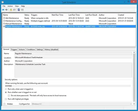

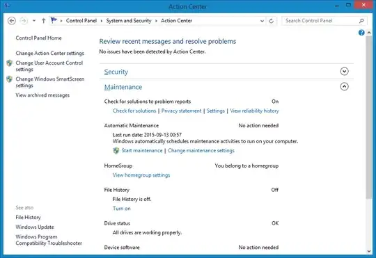

Well, I have not really had a lot of time to investigate this. This problem sort of comes and goes, and I don't have all the time in the world to sit by the computer and wait for it to misbehave. But at least in my case, this appears to be related to the internal workings of Windows 8 and its different scheduled tasks and triggers.
a
You can see from the screenshot above that the automatic maintenance last ran on 2015-09-13 at 00:57 hours. Despite the fact that automatic maintenance is disallowed according to the settings, as seen in Action Center.
b
Note that the option "allow scheduled maintenance to wake up my computer at the scheduled time" is checked.
Windows automatically runs scheduled maintenance on a daily schedule when you're not using your computer.
This includes tasks such as software updates, security scanning, and system diagnostics. This maintenance will run daily if you aren't using your computer at the time you've chosen. If your computer is in use at the scheduled time or maintenance is behind schedule, Automatic Maintenance will run the next time the computer is not being used.
Pay attention to the last sentence in that text. What they left out is that it will wake the computer if necessary. "Automatic Maintenance will run the next time the computer is not being used [and wake it if necessary]."
I am often late with installing Windows updates, and I install them manually. This is because I need my computer for work, and I prefer to review the updates before they are installed. I therefore prefer to install them at my own pace and when I have time. I simply like to be in control of my own computer. Not some wise guy from Microsoft telling me how to run my system. But because my update installs are often overdue, the Windows 8 is apparently configured to kick in some of these scheduled tasks, and even wake the computer if necessary and install the updates for you, and successfully install the updates by overriding your user preference not to install updates automatically.
They have stepped this up now in Windows 10 to the point where you as a user don't even have the choice to review and install updates manually. Go figure... your computer is remotely controlled and dictated to from Redmond. Nice!

But the reason the computer is still being waken up is highly likely because of the way Windows 8 is configured to trigger scheduled tasks that wake the computer. In my case, these appear to be caused by overdue Windows update installs.
e
You can see in the screenshot above that the Regular Maintenance task last ran on 2015-09-13 at 00:57 hours. That's the same date and time as seen in Action Center.
I believe this is what's causing the infamous Wake Source: Unknown string to be printed for the powercfg -lastwake command. If you want to try to prevent the computer from waking up unexpectedly (and gain back some control of your computer) I would suggest disabling all of these scheduled tasks:
\Microsoft\Windows\TaskScheduler:
  • Idle Maintenance
  • Maintenance Configurator
  • Manual Maintenance
  • Regular Maintenance
\Microsoft\Windows\WindowsUpdate:
  • AUFirmwareInstall
  • AUScheduledInstall
  • AUSessionConnect
  • Scheduled Start
  • Scheduled Start With Network
You will find these by running taskschd.msc from the run prompt and navigating to their location.
