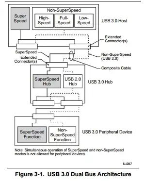

The real problem comes when we see the USB 3.0 specification:
As we can see in the image, the USB 2.0 HUB is completely separated from the USB 3.0 HUB (SuperSpeed), witch means that USB 2.0 devices can't use the SuperSpeed bandwidth. That's a major drawback on my assumption that I could use more USB 2.0 devices with a USB 3.0 controller.
As this specification is kinda old (about 2 years), can someone confirm if there is some new implementation of the USB 3.0 specification that shares the SuperSpeed bandwidth between USB 2.0 devices?

There will never be a change in this design of an additional USB-2-Hub-Device inside USB-3 because it's the only way to provide reasonable downward compatibility. If you want to use USB-3 Speed you need to use USB-3 Webcams.
Let me give you a example for further explenation. Let's say:
Ok, we build a high speed railway. Because the railway is high speed we can put more slow trains onto it than on our slow railway. Hurray!
Technically it's the same for USB. Just because you could drive faster on the railway does not mean there is more space (bandwidth) for slow trains (USB2). The slow trains will drive slow on the fast track, making it impossible for the fast trains (USB3) to use the railway at full speed. To deal with this some engineers decided not to replace the slow railway with the faster one, but to build it right next to it. With this setup it is possible for the fast trains to drive high speed on the fast railway and the slow ones on the slow. Same for USB3 downward compatibility.
Mose
  • 573
  • I was about to answer my own question, but your analogy is really good. I will edit my question (when I have time) to put together all the info I obtained during my tests and research to clarify the subject for further researches. So, the answer to my question is simple: it's not possible to plug 50 webcams in a single computer. There are no 3.0 webcams on the market yet, there are just industrial cameras for sale (very expensive), sadly. – Ian Medeiros Nov 14 '12 at 16:42
