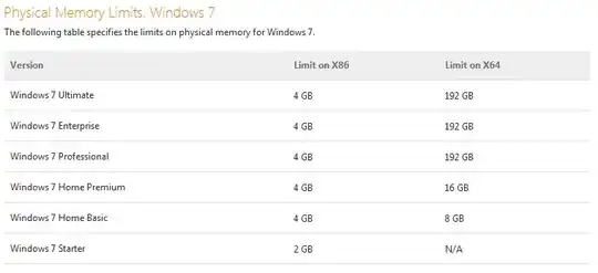

From Memory Limits for Windows Releases:
(See full table for further details about user and kernel-mode virtual address space limits etc.)
That bit highlighted in red is probably where you got that idea of a 25% limit from. Yes, only ~3 GB of RAM out of 4 GB installed is available to 32-bit processes on 32-bit versions of Windows, and this hasn't magically changed with Windows 8. As for why this is, I'm not going to bother repeating all the articles on the internet that have already explained this in detail, including Jeff Atwood's Dude, Where's My 4 Gigabytes of RAM?

  • http://technet.microsoft.com/en-us/sysinternals/ff700229 good tool to see how the RAM is used. – akira Nov 05 '12 at 16:36
  • These are limits specific to 3GB/4GB. His question was clearly about a 25% limit that scales with the amount of RAM you have. So this can't be what the OP was asking about. "That was fine when Vista was designed, when machines had 1 GB of total memory, but is pretty daft for today's 8 GB machines." – David Schwartz Nov 05 '12 at 16:38
  • @DavidSchwartz: Then he needs to specify where he got this info. from, as you yourself stated above. It's entirely possible he read something and then extrapolated it without hard evidence about the limit on modern machines with oodles of RAM. – Karan Nov 05 '12 at 16:41
  • I agree. We can only guess what the OP was thinking. There is no 25% limit. There are virtual memory limits that apply to 32-bit processes and physical memory limits that apply to 32-bit operating systems. (And the other, harder to hit, limits in the table above.) – David Schwartz Nov 05 '12 at 16:41
  • @DavidSchwartz: Yup, the only reasonable explanation I could come up with for that number was the bit highlighted above. ~1 GB unusable out of 4 might imply there's some sort of hard-coded 25% limit to someone who doesn't know the reason. – Karan Nov 05 '12 at 16:44
  • That actually makes sense. Maybe he heard that only 3GB out of the 4GB *virtual address space* was available to a 32-bit process and thought that had something to do with physical memory. Of course, it has nothing to do with physical memory at all and is purely a virtual memory limit. (Although that makes his comment about using the pagefile inexplicable, but who knows.) – David Schwartz Nov 05 '12 at 16:45
