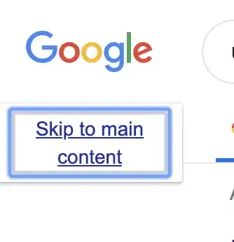

As of now, Google Chrome has this feature re-enabled by default. Upon searching, press Tab, Enter and focus will change to the first result link.
This is now called the Skip to main content feature - between key presses you'll see this enter image description here
