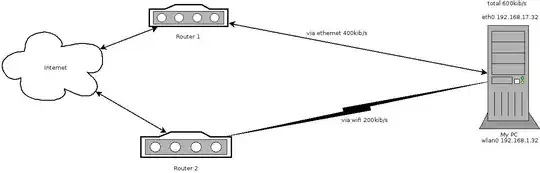

I have to different ISPs, each on each own network. The main connects via ethernet and the secondary via wifi. The two networks have no relation at all. I just connect to them simultaneously. The reason I want to load balance between them is to achieve higher Internet speeds. Note: I have no advanced network hardware. Just my pc and the two routers that I have no access... main network:
if: eth0
gw: 192.168.178.1
my ip: 192.168.178.95
speed: 400 kbit/s
secondary network:
if: wlan0
gw: 192.168.1.1
my ip: 192.168.1.95
speed: 300 kbit/s
A diagram to explain the situation:

  • what is your exact question? A useful link to understand what you are trying to do is http://linux-ip.net/html/linux-ip.html#adv-multi-internet – teissler Dec 19 '12 at 10:06
  • I'm trying to achieve greater internet speeds with multiple internet connections – dzervas Dec 22 '12 at 10:34
Unless you can somehow split up the traffic based on their local parameters (like LAN IP), using this solution you will end up having a lot of random errors because a lot of sites don't allow you to use the same session from radically different IP addresses, not to mention other protocols like FTP, DNS, etc.
If you really want to do this, you will need to rent a (virtual) server with at least 2 IP addresses and build a VPN on each of your connections, then set up an OSPF load balancing to utilize both connections equally. Your server will need to have at least the double of your two connections' speed together.
In summary: without network support failover works well enough, load balancing however is going to be a constant pain.
Update: What you need to do:
  1. Set up the server and make sure your local machine sees the two server IP's through different connections.
  2. Start two OpenVPN servers on the server, listening on each of the addresses.
  3. Start two OpenVPN clients on the client.
  4. Install Quagga on both the server and the client.
  5. Make sure the server and the client see each other through the OpenVPN without advertising any routes yet.
  6. Set up routing advertisement on the server so the default route (0.0.0.0/0) gets advertised over OSPF one link to the client via redistributing static routes. (This is hard.)
  7. Add the second link as a backup link over OSPF.
  8. Change the configuration so the two links are used in load balancing modes.
OSPF is a whole new world, it's an integral part of how the internet out there works. If you really want to do this, I recommend you give yourself time and read some books as it is way out of scope for this description. I've done this once and I might get back to writing a tutorial on this, but it will take considerable time so I'll make no promises.
