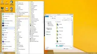

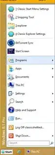

As the other answers have stated, the old, non composited classic theme is gone, and all the other answers do is suggest you tweak the theme. Lets face it - its not a classic theme without a proper start button and menu. On the other hand, if you want all that modern/metro/windowsui/whatevertheycallitthisweek goodness, you need a start screen. You can probably use my solution, in conjunction with either classic, or new shiny windows 8 themes to get something that close enough to a windows XP or 7 system UIwise. It also contains a explorer tweaking tool that brings it closer to a classic windows explorer window
It takes a bit of tweaking to get it just right but you can get something pretty close to what you want with a combination of classic shell and small taskbar buttons set to "never combine" through the regular taskbar settings. You can also tweak to select the explorer style you want
. In this case, I've created a new account (the horrible yellow wallpaper is a default!) and set this up like an XP system. You can also use a 7 style start button, and/or 7 style explorer settings.
You can use the start screen menu as you see here to access the start screen/metro.I do believe you can also pin that in order to get a modern ui/strat screen launcher, and presumably set another shortcut to it.
Unlike a theme hack, this is a standalone application that can be easily installed and uninstalled, without having to resort to ugly things like patching and other hacks. It also uses the DWM (unlike the classic themes), so you're not missing out on the graphically accelerated (and actually faster) UI with aero. You can also uninstall it cleanly if you're not happy with it
