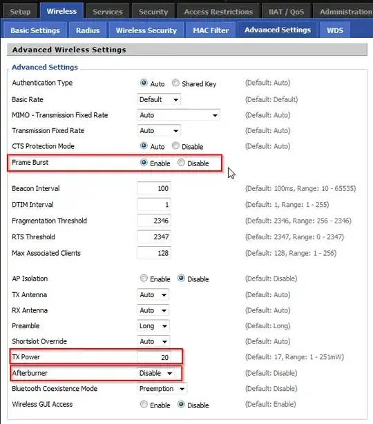

However there are other options that you can play with in the advanced settings in DD-WRT that might improve your speed.
Other options that might be of value include enabling Frameburst and afterburner. Make sure you test as this could potentially make the performance worse. Also read up the max values suggested for your transmit power. For my router an asus rt-n16 its different, its in dB not mW which is why it is a much lower value. This is an exception. Your router, which I've had before, is definitely in mW. Generally the default value for this is just fine.
You may also want to change your wireless adapter settings on your computer. This is outlined here and also here.
If you have the options there for frameburst or afterburner enable it. You'll want to test after each of those changes.
If you have a transmit power option set it to the highest or max performance rather than max power savings. There shouldn't be any negative effects from this except for battery life.
