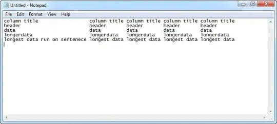

This is certainly not simple to explain... but after it is setup it will work with minimal effort. Also this is a slight variation on what @pnuts has outlined
I suggest using a template spreadsheet that you can copy-paste to. the template i have created has 3 tabs that look as follows.
tabs
  • Data tab is where the data is pasted
  • Length is going to do some math to determine the longest column
  • Space insert is going to insert the appropriate number of spaces (edit) you can copy from here and get the correct result
the length tab looks like
length
Row 1 has maximum characters of the column below is and contains the formula
=MAX(A2:A101)+1
+1 creates the delimiter.
Row 2 through to n (which i have extended to 100 for this example) contain a formula to evaluate the length of each string
=LEN('Data tab'!A1)
the space insert tab looks like
space insert
Each cell contains a cell to evaluate the length of itself in comparison with the max value (+ delimiter) and insert an appropriate number of spaces.
='Data tab'!A1&REPT(" ",length!A$1-length!A2)
Note the $ which locks Row 1 if you copy and paste the formula
(edit) you can copy from the space insert tab.
notepad
Pynner
  • 401
    Ingeniously contrived! – einpoklum Dec 23 '12 at 11:15
  • But... why do I need the last sheet, really? I can copy-paste from the third sheet. Also, I don't want to use any long formulae replicated for each column. – einpoklum Dec 23 '12 at 19:20
  • Quite right.. last tab not required... i had assumed that the cells would insert additional characters. I will update my answer to fix it – Pynner Dec 26 '12 at 01:44
