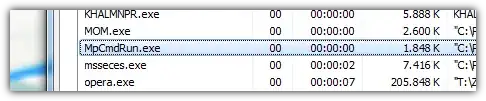

Use a VBS file instead of a CMD file and schedule it as usual with your Task Scheduler.
VBScript's run method can open other programs in a hidden window via its second argument (, 0). The tricky part was the escaping together with the argument -SignatureUpdate
set objShell = createobject("wscript.shell")
objShell.Run("""C:\Program Files\Windows Defender\MpCmdRun.exe"" ""-SignatureUpdate""") , 0
Now you won't see any window during Windows Defender update. Only a task manager process is visible:

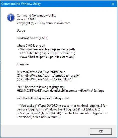

Here's a free app that will hide the command window:
Schedule it as such:
cmdNoWnd "C:\Program Files\Windows Defender\MpCmdRun.exe" -SignatureUpdate
I set it up to run every hour in Windows Task Scheduler.
