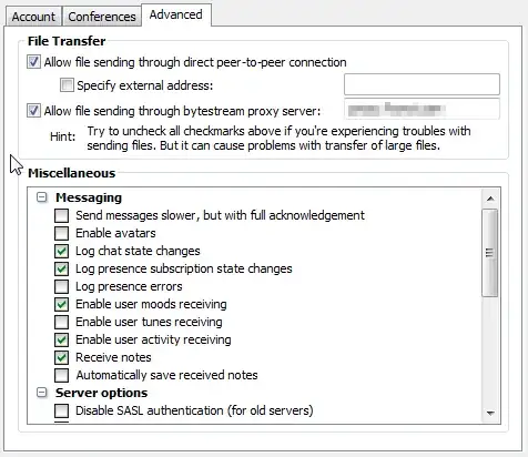

Actually the clue is in the error message. For most connections, it won't be possible to set up a direct connection between two peers, even if you allow it (see screenshot below). One main reason would be NAT.
The solution is to use a bytestream proxy that both peers can use and configure Miranda for that. It is likely that your side is the failing one from what you describe. In general, of course, it could be that either or both sides fail. So looking at the other person's settings may be necessary.
Options dialog of Miranda IM
The second checked checkbox and the accompanying edit field are what you are looking for.
Also note: the bytestream proxies are services in the XMPP ("Jabber") sense, so the names, albeit appearing as DNS names, may not be entered in the DNS server, if you are connected to the Jabber server's domain that offers the bytestream proxy. The canonical name is usually proxy.domain-name, at least in OpenFire it used to be and ejabberd it is.
