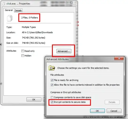

13
With Total Commander, you can do a search (ALT+F7) on various attributes of files and folders.
The "encrypted" attribute is one of them.
alt text
Once you have found all encrypted files and folders, select "Feed to listbox". It will put all names in the selected pane (left or right). There, you can select them all, right-click and select Properties. You'll get the Properties window for all the selected files. In the Advanced window, you can easily decrypt them by unchecking the "Encrypt..." checkbox.
alt text
