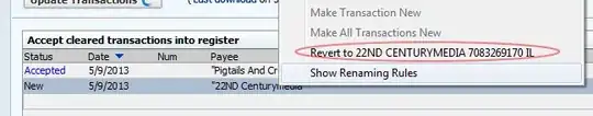

To undo an automatic rename, just right click on the transaction under "accept cleared transactions into register." Then select revert as shown below:
