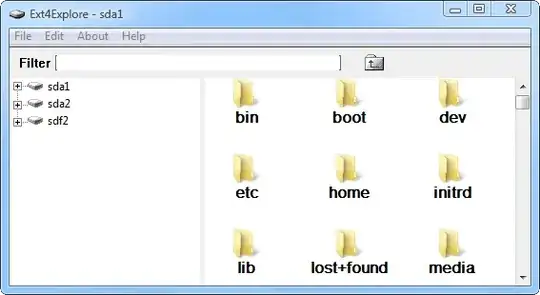

Here's another one I found to be working: Ext4Explorer.
I get the same results with Ext4Explorer. I can see the two partitions on one device (internal HDD) and the one partition on the SD card. Here's a screenshot.
ext4explorer
But unlike both Ext4Explorer and Ext2Read, the Linux Reader actually shows you how many files you have and some basic information about a file when you open up a folder. The former two do not. If you want to know how many files there are when using either one of the two you have to count the files.... ridiculous!
