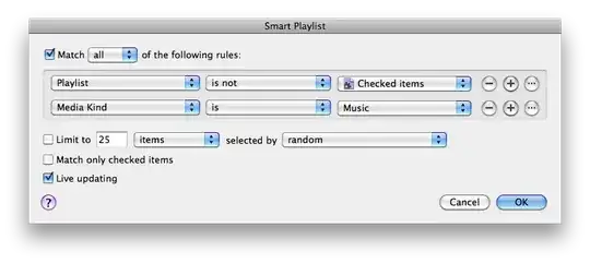

Most definitely! Although you cannot directly create a smart playlist to contain only unchecked items, there is a bit of a 'work around' to make one.
  1. First, create a smart playlist to match the following rules, with the key emphasis on "Match only checked items":
    playlist 1 rules
  2. Then create another with these rules, where the "Checked Items" is the playlist you just created.
    playlist 2 rules

  • “Skip when shuffling” (select a track, Get Info, Options tab) is not the same as “checked” (the check mark before the name of a track in list view). – Chris Johnsen Oct 27 '09 at 07:11
  • Thanks Josh, but Chris is right. I already have a playlist to pick up "unchecked tracks" but it's "exclude from shuffle" that I'm having trouble with. – LeopardSkinPillBoxHat Oct 27 '09 at 23:26
