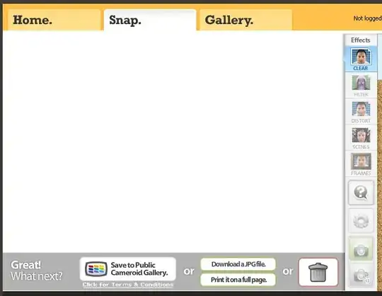

    Do a quick check: go [here](http://www.cameroid.com/snap.php), tell me if you can use your camera there. – matan129 Jul 02 '13 at 17:28
  • @matan129 no, doesn't work http://i.imgur.com/7VGUYq3.png – Alex Jul 02 '13 at 17:33
  • OK, that means the problem isn't with Skype only. Try updating the webcam drivers. – matan129 Jul 02 '13 at 17:34
