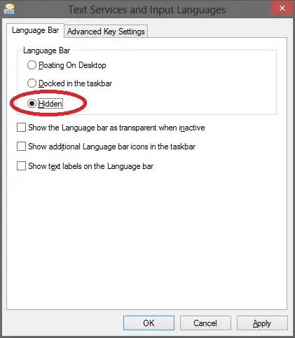

I have gone into the logical location in the settings that deal with input and language control and the Hotkeys that deal with them. As you can see in the picture I had supplied, I have already removed the Hotkey for toggling [Please see image below], but Pressing [Windows]+[Space] still toggles the Input Mode.
No Hotkey
It seems in Win8, they have these options, but then just ignore them and do whatever it wants anyway as I have ALSO set language bar to be Hidden. But as you can clearly see in the screenshot, it's still there.
Hidden Selected Still Showing

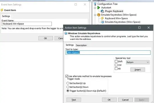

I use a combination of Pulover's MacroCreator and EventGhost. But you should be able to do this just using EventGhost.
The nice thing about EventGhost is that you can still use Windows+key shortcuts in another application so you don't need to disable the windows key completely.
For example, for the windows+space shortcut. You just need the keyboard plugin in Autostart, and a macro to emulate the win+space keystroke in the active application.
In the macro, you'll need the event (Keyboard.Win+Space), followed by an Emulate Keystrokes action, with the Text to type being {Win+Space}, and check the box for use alternate method to emulate keypresses.
http://www.eventghost.net/#download
I'd recommend using the stable 0.4 release since the 0.5 pre-release has some errors on startup that may cause problems.
