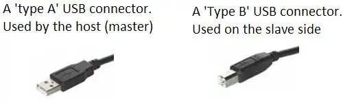

USB used a master-slave setup.
Usually one has a host which acts as a master, and a slave device with a totally different role. Those two are not interchangeable. USB even uses clearly distinct connectors to indicate the kind of device and to make sure that you connect a master to a slave, and not two slaves or two masters.
USB connectors (regular size)
To use your PC as a storage device you would either need an USB controller which acts as a slave, or a controller which can be used both as a master or as a slave.
These are not common. Usually you only find them in a few portable devices (such as smartphones) and there it is called USB on the Go. No regular PC that I know off supports this feature.
