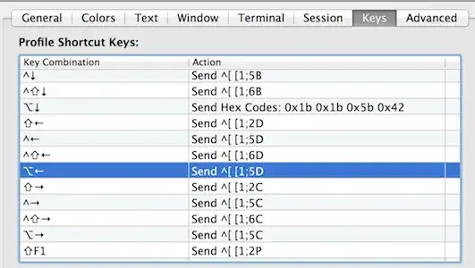

In iTerm's properties go to Profiles -> Keys and setup there
  • For ⌥→ Send Escape Sequence [1;5C
  • For ⌥← Send Escape Sequence [1;5D

  • That doesn't work for me. The escape sequences are sent, but vim only moves one space back and forth. Running the default vim 7.3 that comes with OS X 10.8. Ideally, I'd like to change it on vim's side, not tweaking the defaults of the Terminal emulator (since that'll result in better portability). – slhck Sep 06 '13 at 07:01
  • That's weird, it works both in vim (from homebrew, not a default one) and zsh with the default configuration from oh-my-zsh (in ~/.oh-my-zsh/lib/key-bindings.sh). – eiennohito Sep 06 '13 at 07:04
  • Doesn't work here either, I can use alt + arrow in inside zsh, in Vim it only works with shift + arrow :( – seds Sep 07 '13 at 17:34
  • I checked it one more time on available remote systems (ubuntu 13.04, stable debian, and scientific linux) and it works everywhere. What is the output when you press Control+V, ⌥→? For me it is ^[[1;5C – eiennohito Sep 08 '13 at 09:03
  • Works for me: iTerm/Vi + zsh – Petro Semeniuk Jan 31 '14 at 02:20

None of those answers worked for me. I ended up loading a linux VM and checked what I'd get with <Alt-ARROW>.
The 4 escape sequences which worked for me are those:
  • <Alt+Up>: [1;3A
  • <Alt+Down>: [1;3B
  • <Alt+Right>: [1;3C
  • <Alt+Left>: [1;3D
Be careful to edit the Profile keys and not the main ones which will be overridden by the Profile ones (where Alt + Arrows are set by default to an Hex Sequence which didn't work with vim).
