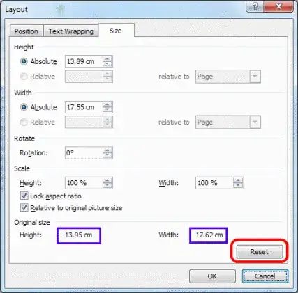

I was able to replicate your issue using the files you posted. I was able to solve it with the following steps:
  • Right-click the image
  • Choose Size and Position...
  • On the Size tab click Reset
  • Click OK to close the dialog
Image size settings
Notice on the screenshot above that even though Word says the image is scaled to 100%, the height and width are different to the "original" size until you click Reset.
I suspect that you might still have problems using images larger than the page though, in which case you should probably use an image editor to scale the images.
