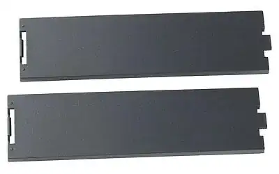

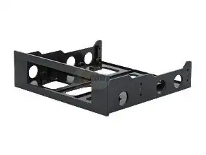

Yes, if your have an extra SATA connector, then you can put a 3.5" HDD in the 5.25" DVD bay, but you will need either mounting brackets (figure 1 and 2) or a 3.5"-to-5.25" adapter (figure 3). If you use brackets, then you will also need a full 5.25" bezel or drive-bay cover (figure 4), and if you use an adapter, then you will need a 3.5" bezel (figure 5).
If you had built the system yourself, then the case would likely have come with the bezels/bay-covers since they don’t know what you would end up putting in the case, but a system from a manufacturer will usually not include them.
You can purchase them online (e.g., on eBay) for fairly cheap (<$5). You can also check with some small “mom and pop” computer shops in town to see if they have some old computers in the basement with them; they will often give them to you for free.

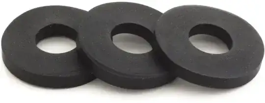

You will also want to use rubber washers (figure 7) to screw it in to reduce vibration and avoid it shaking the whole case, but this is true for all hard-drives, optical-drives, and anything that has moving parts that shake or spin.
Figure 1: Mounting brackets

Figure 4: 5.25" bezel/bay cover

Figure 7: Photo of some rubber washers
