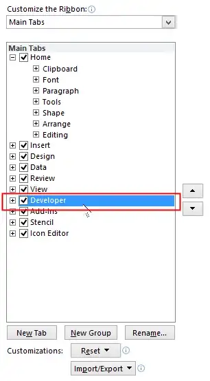

First enable the Developer tab on the Ribbon. Right-click anywhere on the Ribbon and click Customize the Ribbon.
The Visio Options dialog will launch and on the right side ensure that Developer is checked and then press OK.

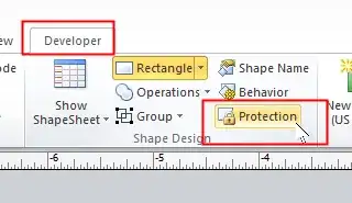

Now Select your shape, go to the Developer tab in the Ribbon, and click Protection.

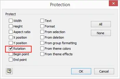

This will launch the Protection dialog. See if Rotation is checked. It is is uncheck it and press OK.
NOTE:
In my experience, when Rotation is protected:
  • with Visio 2010 - the Rotation handle is visible, but grayed-out, and can't be used
  • with Visio 2013 - the Rotation handle is invisible
