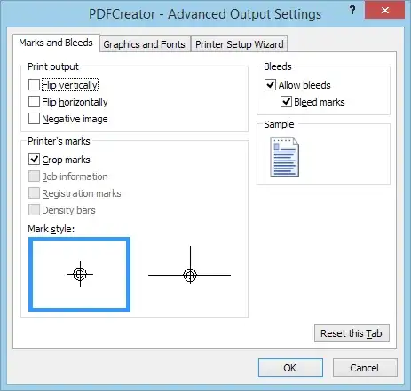

At the end, I solved my problem by printing to PDF (instead of using the Publishers "native" Save to PDF). I enabled crop marks in advanced output settings and used PDF Creator (but probably any PDF capture driver will do).
The results may differ a bit for more complex elements, but PDF Creator files are actually generally smaller (having image compression and downsampling disabled on both sides).
But I did have situations where PDF Creator was unable to render some elements properly, and this is why I tried avoid this path initially.
