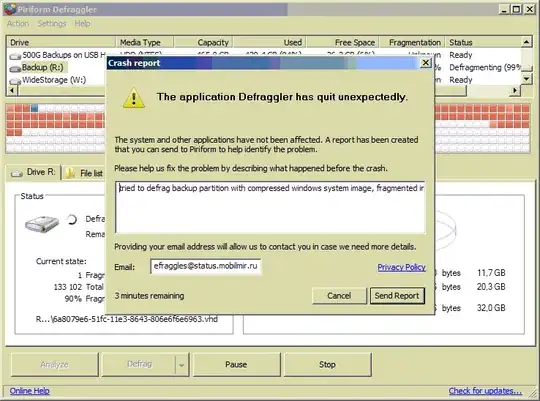

But in process of compressing, file get insanely fragmented, usually above 100'000 fragments for system disk image.
With such fragmentation, defragmenting takes very long (multiple hours per image). Some defragmenters even can't handle it, they just skip the file or crash.

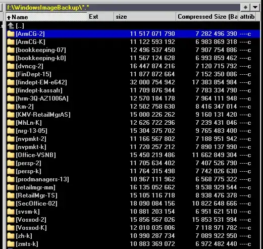

  4. NTFS compression ratio can be good, depending on files. System images are usually compressed to at most 70% of their original size.
    Pair of screenshots for those do not believe, but ofc, you can make your own tests.

  • Also, compression ratio is off-topic, but here are real images of real freshely-installed Windows 7 Professional, (mostly 32-bit, 3 or 4 64-bit) systems with standard set of software: http://i.imgur.com/C4XnUUl.png – LogicDaemon Dec 26 '13 at 20:47

It's true that NTFS compressed files can pose a problem to some defragment tools. For example, a tool I normally use can't efficiently handle them - it slows down to a crawl. Fret not, the old trusty Contig from Sysinternals does the job of defragmenting NTFS compressed files quickly and effortlessly!

  • compression ratio is off-topic, but here are real images of real freshely-installed Windows 7 Professional, (mostly 32-bit, 3 or 4 64-bit) systems with standard set of software: http://i.imgur.com/C4XnUUl.png With compression I really do conserve disk space. And I can defragment files afterwards, but it takes too long. – LogicDaemon Dec 26 '13 at 20:48
