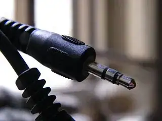

From my experience, most of the time it's not the jack that breaks but one of the wires, usually near the plug:
Jack plugged into a laptop with an arrow pointing to the fragile part of the cable
The issue is very common if you use the same pair of headphones with pocket devices.
This (and broken jack too) can be repaired if you don't mind using soldering gun. New jacks can be bought at very low prices. You can cut the old one along with about 1 cm of cable (it can be already damaged and will fail sooner), remove another 1 cm of insulation and solder wires to appropriate jack leads.
Typical headphones without a microphone have 3-contact 'TRS' jacks like this one...
TRS jack
... but four wires in the cable. Two of them (usually of the same color) should be connected to the center lead (which corresponds to the sleeve). Other two cables should be soldered to left and right lead respectively. After soldering a new jack you should check if stereo isn't reversed, in that case you have to swap left and right wire in the jack.
