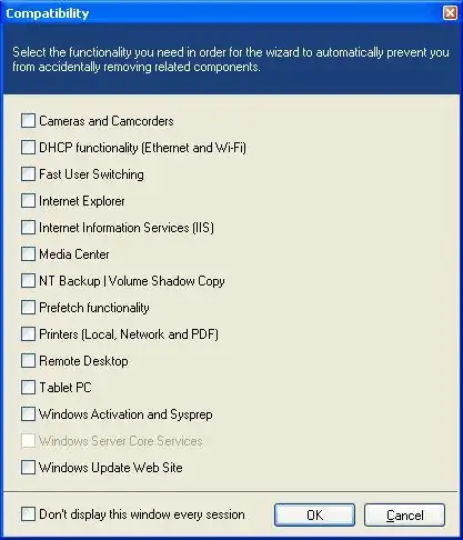

When you were creating the stripped down version using Nlite and you were at this step:
Did you make sure to select "Cameras and Camcorders"? If you didn't do this it probably left the functionality out. Windows keeps asking to install it because whenever you plug it in, it tries to do it and fails.

  • I did select Cameras & Camcorders, and my webcam is working fine for video & still capture. –  Nov 16 '09 at 03:21
