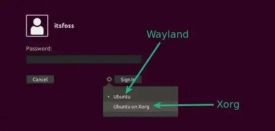

Had this issue on ubuntu 22. Had to enable xorg on login screen to fix it:
user5480949
