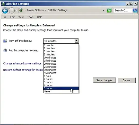

You should be able to change these settings in Control Panel -> Power Options -> "Choose when to turn off the display" on the sidebar.
You can set it so that the computer will never enter sleep mode but still have the display turn off after a certain period of time (up to five hours).
Unless I misunderstood your question, it looks like these settings would meet your needs.

  • Well this is not exactly what I asked. A user can be logged on for 8 hours long. He may not touch the screen or the keyboard but watch sometimes programs that run. I am looking for a setting that allow the turn off of the display only when nobody is logged on but I'm not sure it exists... – Maxbester Apr 09 '14 at 15:19
