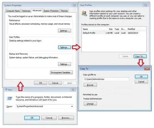

I decided to copy the default-user profile since that is what Windows does whenever you create a new account (figure 1):
  1. Run SystemPropertiesAdvanced
  2. Click the [Settings] button next to User Profiles
  3. Select the Default Profile and click [Copy To]
  4. Enter the appropriate directory
  5. Select the approprtiate user account to set the correct permissions
  6. [OK]
Windows copies the default user profile to the administrator account’s directory. Reboot, and Windows should no longer need to use a temporary profile for the administrator account.

Figure 1: Screenshot of produced to copy default-user to administrator
