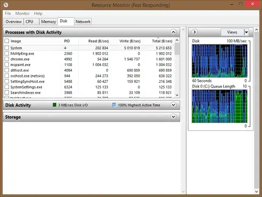

update: Similar case just happened. Any clues from these two ResMon screenshots?
ResMon Disk usage. "System" on top with 5MB per second, MsMpEng.exe trailing with  2MB per second
ResMon Network usage activity. No significant traffic visible
"System" doesn't really tell me much.

  • @jet I now have uploaded two ResMon-screenshots from today – Nilzor May 02 '14 at 10:51
    MsMPEng (Widows Defender) can cause SIGNIFICANT disk and processor usage, I always remove it from my windows installations. And as visible in the screenshot, you get up to 100MB/s usage of your disk. Try disconnecting your PC from the internet, then temporarly disabling windows defender and search indexer and windows update, and any other non-microsoft services, processes AND scheduled tasks. There have also been reports of bad windows installs, which after a clean re-install worked normally. – Gizmo May 02 '14 at 11:01

I downloaded your Process Monitor log and did a count for the number of times each file was being accessed during that 6 second trace you captured. You should be able to see this yourself in Process Monitor by going to Tools -> Count Values Occurences -> Select Path from the Column drop-down and then click on the Count button. Click the Count button to sort the count numbers in ascending/descending order. Double-click on any of those file paths to focus on them.
The top 4 file paths accessed are: 3276 times: HKCU\Software\Classes\Local Settings\MuiCache\de\417C44EB 3276 times: HKLM\SYSTEM\CurrentControlSet\Control\MUI\StringCacheSettings 2188 times: HKCU 1457 times: C: (this is the searchindexer that's accessing this)
Processes involved in the above accesses include SearchIndexer.exe and services.exe and they seems to repeating the request for accesses over and over again. Not I sure I know what's going on further than that but I suggest you try disabling your Windows Search indexer and see how that affects performance.
I also had another look at the trace in an unfiltered format and saw lots of access to various Software Distribution folders with paths prefixed with C:\Windows\SoftwareDistribution\Download..... so worth checking/disabling this and see how that affect performance.

I would be cautious about what you are using to determine that the disk is running at 100%. What does this mean?
That the disk is running at max throughput? No, how does your computer know what the maximum speed of the disk is? Given the optimistic speeds provided by manufacturers, I'd be staggered if you ever reach 100% of top speed for any length of time.
I think more likely the 99% you are looking at is an approximate measure of when the disk is in use... i.e. at the time of observation is is continually being written to/read from. This doesn't mean it will be working at full speed. You are more likely hitting a larger number of smaller files. SSDs don't have the same mechanics of a conventional disk, but there are overheads when reading/writing lots of small files.
If you run one of the dozen benchmarking applications out there, you'll find out exactly how fast your disk works and it will be way higher than 1GB/s! If you look at your first image, you see that the highest (green) peak is approx 60-70GB/s which is reasonable-if-unremarkable real-world speed for your disk, but most of the time, it is running slower. On the same image, we can see that you have a queue depth of 10.... it means that disk operations are stacking up.
