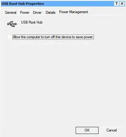

I have installed a USB 3.0 hub on my desktop computer.
I use it to connect an external USB 3.0 disk for backup purposes, and I have a problem: Windows 7 enables by default power saving for said hub, which causes the disk to disconnect during intense I/O operations (e.g. my scheduled backup at 8 p.m.).
I can disable this setting by doing the following:
Go to the Device Manager > Right click on the hub > Properties > Power management > Uncheck Allow the computer to turn off this device to save power
Too bad, every time I restart the computer, the box is checked again. Is there a way to disable this setting permanently?

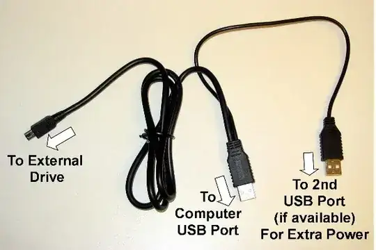

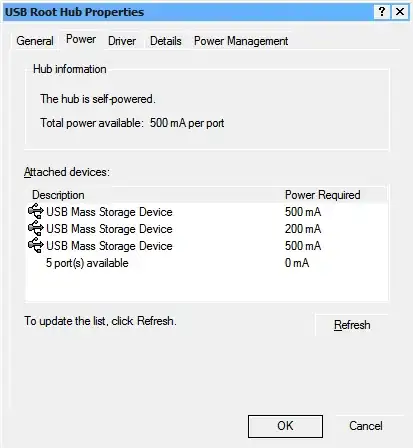

Are you sure the drive is shutting down to power-management and not simply because it is trying to draw too much power? You can check the power draw on your USB hub via the Device Manager (figures 1 and 2). Verify that the power that the hub can provide per port is sufficient for the external drive. If not, you may be able to use a USB Y-adapter (figures 3 and 4) to draw power from two ports. (High-draw external drives usually come with a Y-adapter specifically for this purpose, so double-check the box and manual.)

Figure 2: Screenshot of power draws on a USB hub
Figure 3: Photo of a USB Y-adapter

Figure 5: Screenshot of Power Management tab of USB hub
