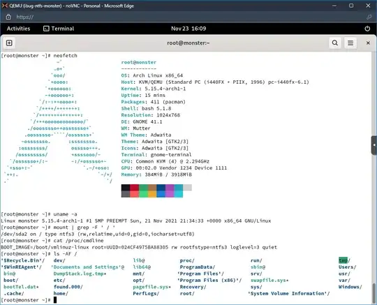

As of 5.15 Linux can be installed on NTFS (though it may break at any minute), and even alongside Windows.
Arch Linux
Do not try this unless you're familiar with both Linux and Windows.
