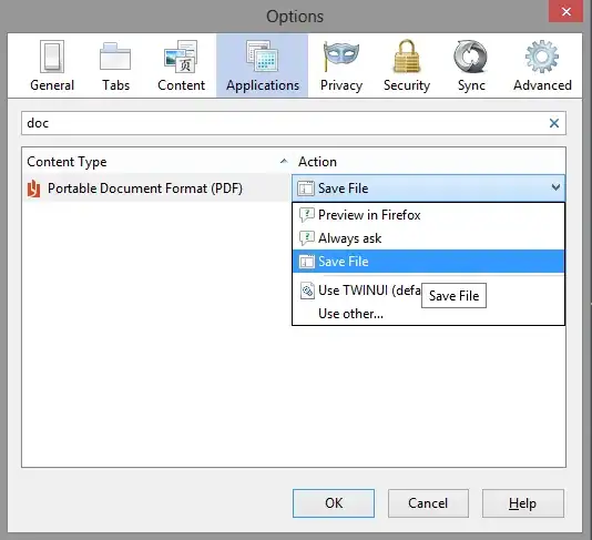

You cannot set the dialog box to appear but for a certain radio button to be checked. You can only change the default option.
You can do this within Options > Applications and then searching by the file type. See below:
