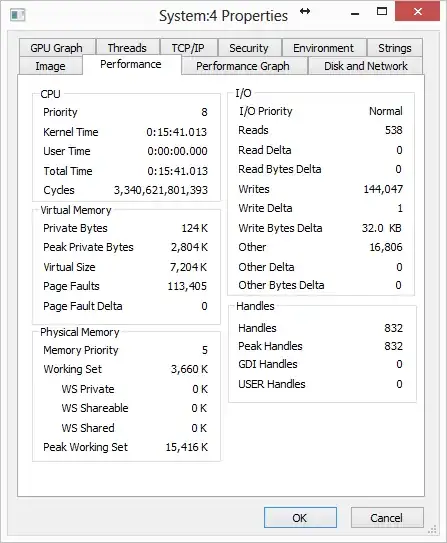

I was in the same situation a few months ago. I have 2 PCs at home, both run on the same OS/version. One day one PC started showing difficulties connecting to my gmail - google would say "connection not trusted". After initial analysis, I noticed that all sites were now are under control of DO_NOT_TRUST_FIDDLER_ROOT certificate. When I compared the cert. with another PC, such did not exist. I went through numbers of recommendation but nothing helped out. Being reluctant to re-install OS, I did this: copied all web certs from "good" PC and replaced "bad" ones on the second PC. Only then everything lined-up!! IN FUTURE, I WOULD RECOMMEND TO MAKE BACKUP OF ALL WEB CERTIFICATES BEFORE THE PROBLEM ARISE.
