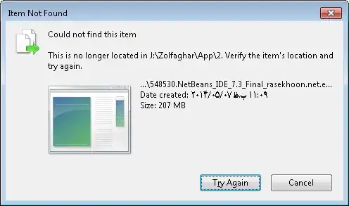

I want to delete a file but it shows an error: "System cannot find the file specified"
what's the problem?
the file which I want to delete:
when I delete the file:
the file name is :
down2\548530.NetBeans_IDE_7.3_Final_rasekhoon.net

    Looks like you have disk/file-system corruption. Please edit your question to include what you've tried already, and what the results were. For example, have you done a disk check on that drive yet? – Ƭᴇcʜιᴇ007 Jul 24 '14 at 17:37

  • thanks , I used chkdsk and it has been fixed:C:\Windows\system32>CHKDSK /F J: 8 large file records processed. 0 bad file records processed. 0 EA records processed. 0 reparse records processed. CHKDSK is verifying indexes (stage 2 of 3)... 63 percent complete. (273060 of 355684 index entries processed) Deleted invalid filename down2\548530.NetBeans_IDE_7.3_Final_rasekhoon.net.exe ( 275059) in directory 274985. ... – abdolahS Jul 24 '14 at 21:29
