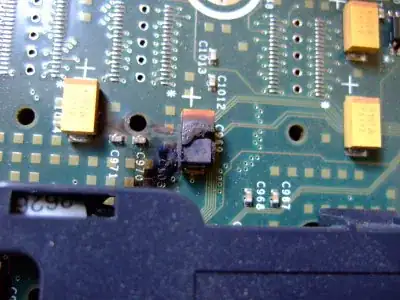

    Yep, I agree with most of the others -- probably a capacitor. Sometimes a motherboard or adapter board will have several "decoupling" capacitors wired between "hot" and "ground", and if one of those shorts internally (which they do with fair regularity) you will get a brief fire and smoke, but often the computer will either continue operating or will crash but reboot with no obvious problem. I've personally observed this on a couple of occasions. – Daniel R Hicks Jul 28 '14 at 00:32

A burning capacitor could be your culprit. Regardless, if you saw a flash, or fire and noticed any smoke, the fact you've not noticed any problems simply means you've not yet tried to use whatever is broken. There isn't anything inside your computer that will keep on working happily after burning up. You should open up the computer and see what's been damaged. If you don't address the problem while things are working, you may have a small problem turn into a bigger and more expensive problem.

Almost certainly a Capacitor.
This happened to a Dell server that was running under my bed (don't ask, but basically to reduce the noise in my room) and didn't have enough ventilation.
Usually the area of the cap burst has smoke residue around it and in my case there was a strong smell associated with the burst and a 'pop' sound.

The most likely culprit is a capacitor. Every part has a reason to be there; no part can fail without some adverse consequence on the system's operation (even if it's not immediately apparent). If the system appears to be working OK, then (total speculation) it might be a power supply filter capacitor on the mother board. Electrolytic capacitors are notorious for having very finite operational lifetimes. Of all components used in a computer (and computers contain lots of them), an electrolytic capacitor is most likely to be the first part to fail. These devices are also notorious for going up in a puff of smoke when they do fail.
Power supply filtering (one possible application of a capacitor) is intended to smooth out the voltage on the power bus. Without it, there will be more noise and voltage dips/spikes on the bus than with it. This is generally not a good thing because it can increase voltage stresses leading to failure of other parts, and at the very least can make the system unstable - prone to random glitchy behaviour of programs or the system as a whole. Although a filter capacitor could fail any time the computer is in operation, the most likely time it would occur is when the system is powered up, due to associated inrush currents and voltage surges. Although it could be located in the power supply, the fact it was so visible to you, and that it didn't have any immediate apparent impact on operation suggests that the failed part was likely on the motherboard. The capacitors in the power supply are usually much larger, and a failure of one of those would be more likely to produce an immediate, noticeable effect - the power supply going totally inoperative or the system being unable to start up on the degraded power.
Any evidence of smoke/fire should be followed up by careful inspection and checkout to identify and repair/replace the failed part. Continued use of the damaged and unrepaired system would not be a good idea.
