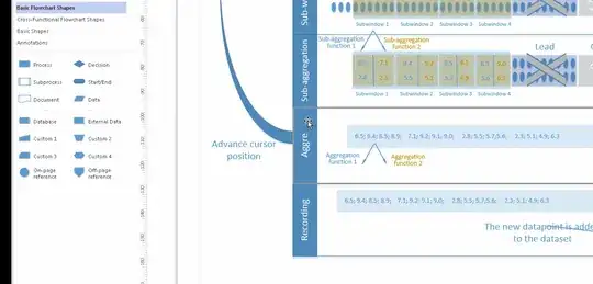

I am trying to reduce the height of a swimlane in Microsoft Visio 2013 using drag and drop as usual but it doesn't seem to work:

but 31.7333 mm seems to be the minimum.
Is there any other way to reduce the height of a swimlane? Its minimum height seems to be locked somewhere. I did look in the swimlane's container ShapSheet: nothing caught my attention but some properties are pretty esoteric to me.

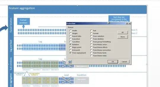

Following Devid's answer, I unchecked the height protection for both the swimlane and its container, although it does sound like the solution it didn't help:
Swimlane's protection properties:
Container's protection properties:

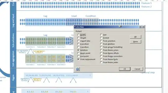

Protection properties of the container of the container:

Some shapes won't resize because they have locked attributes like height and width. To change this you have to Click on the Developer Tab → Protection → Uncheck protected attributes → Resize the shape.

  • Thanks, I unchecked the height protection for both the swimlane and its container, although it does sound like the solution it didn't help. I added some screenshots at the end of the answers. Here is the [file](https://www.dropbox.com/s/pljr8ohd02g6ems/feature_aggregation-with-option.vsdx?dl=0) if it can help diagnose. – Franck Dernoncourt Aug 31 '14 at 23:33
  • @FranckDernoncourt ok tomorrow I will download the file and check it for myself and see if I find a solution. – Devid Aug 31 '14 at 23:41
  • I checked it and made a new Swimlane and chenged the protection and resized it. So the problem is not the swimlane. I then checked your diagram and I think there are objects inside the swimlane which are protected. That is why it won't resize. – Devid Sep 01 '14 at 14:25
