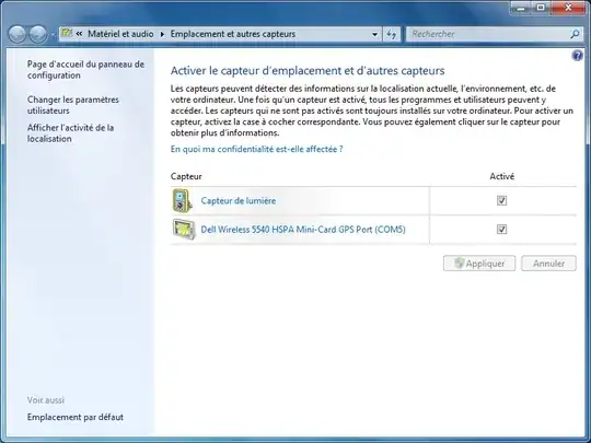

The first solution is to disable the ambient light sensor (ALS) in case your system has one, this can be done in the control panel, but it's faster to just type "sensor" in the start menu's search bar and it should bring up the corresponding control panel in the results; then just uncheck the "Light sensor" and apply.
Control panel screenshot

The screenshots are in French but the item's locations are the same so you shouldn't have too much trouble finding your way.
