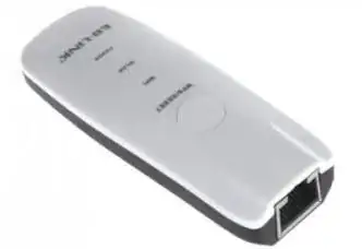

I have a portable mini wireless router with different functions (AP/Client/Router).
Can I use a ethernet splitter to give internet access to two devices? The router only has a ethernet port and connects to a wireless network (Cliente mode).
I know that a switch would be the best option but I dont have one and they are expensive.
Ethernet splitter Portable router

  • @DavidPostill that question didnt help, i read it before. It looks Hennes answer is adequate for my case – NeDark Sep 20 '14 at 19:56
  • @barlop it's expensive compared to a splitter, i cant find one in ebay under $10 – NeDark Sep 20 '14 at 19:57
  • @NeDark I suggest trying social security(e.g. support for people on a low income if that's an option in your country)..or if you're young, then parents(i'm sure they can afford something <$20 even if they pretend otherwise). travelling to get somewhere where I live is typically more than $10. as you say, does seem to be a a bit more than $10 as you say but anyhow here is one on buy it now for $5 http://www.ebay.com/itm/TP-LINK-Technologies-TL-SF1005D-5-Ports-External-Switch-/161401174644?pt=US_Network_Switches&hash=item2594427a74 – barlop Sep 20 '14 at 21:22
  • @barlop thanks for your suggestion, it looks i can use an old router as a switch http://www.ehow.com/how_2308635_use-router-switch.html – NeDark Sep 20 '14 at 22:57
  • @NeDark yes turn off NAT and DHCP and also something mentioned here. http://forums.whirlpool.net.au/archive/1996394 give it an IP on the same network but outside the DHCP range. I think that's so that a)you can access the web interface b)so it doesn't give another computer the same IP as the device you're using as a switch – barlop Sep 21 '14 at 00:06

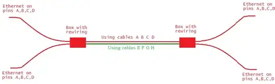

No.
A star shared regular Ethernet network can not be split by just tying cable together. If you want to connect two devices simultaneously to the same cable then you ether need a hub or a switch.
The device you are showing in your post is either one of these two:
  1. A physically wired 1:1 splitter which means that you need to switch off one of the devices connected to it while the other is connected.
  2. Or a dual 100mbit Ethernet over a single 8 wire cable.
The explain these a bit more:
Plain old 10/100 Mbit Ethernet has a standard cable with 8 wires, 4 of which are used. If you creatively rewire a few of these and (un)rewire those at the other end you can use two fully independent connections of the single cable.
Note that this just act as two cables in a single cable package and that you still need something to get the devices to talk to each other.

  • Actually, if you look closely at his problem description, a switch won't work either. His router is connected in client mode, and so it will bind to the first hardware address it sees. – David Schwartz Sep 20 '14 at 18:14
  • I am not sure how to parse a client mode. I read it as it is a AP with a wired and a wireless connection. Is it a 'wired to wireless bridge'-ish thingy which uses the wired NICs MAC as wireless MAC? – Hennes Sep 20 '14 at 18:53
  • @Hennes no, the mini router has a fixed MAC for wireless and a fixed MAC for ethernet. It support NAT and the deviced connected to ethernet is put on a different subnet. Example: Wireless network: 192.168.1.0/24, router wireless client IP: 192.168.1.66, router ethernet nat gateway: 192.168.2.1, device ip: 192.168.2.91 (Wireless network - Mini router - Device) – NeDark Sep 20 '14 at 21:41
  • The middle line of that diagram is bad... it uses D twice. – T.J.L. Nov 14 '17 at 21:50
  • Wow. You are right. And possible the first to notice since it was posted on 2014... Diagram corrected D E F G -> E F G H and cabled to cables. And after correcting I guess 'wires' would have been better. – Hennes Nov 14 '17 at 23:25
No, for two reasons.
The Ethernet splitter just allows two Ethernet links to run over a single cable. You don't have two Ethernet links, so the splitter doesn't help you.
But also, you can't build out from a client connection. When you make a client connection to an access point, you only have one hardware address. The access point (which is what your router is acting as) will register the first hardware address it sees as the other end of the client connection, and the other device won't work. The WiFi specification requires this behavior of the access point you are connecting to. So a switch won't help you either, sorry.
You could get another mini router. You could get a wireless router that is specifically designed to bridge multiple devices to a client connection. You could connect some device that supports Internet sharing to the mini router and connect the other device to it.
