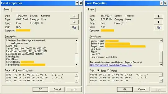

I enabled Kerberos error logging on the server.
Here is what is now appearing in the system logs:
