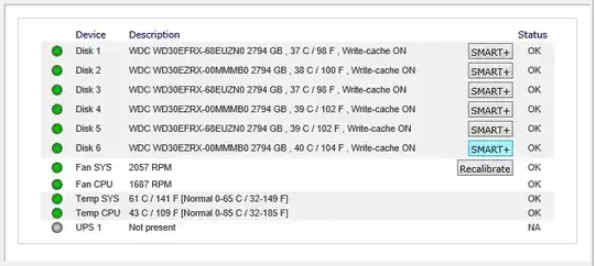

See screen shots – the numbers speak for themselves (11 million load cycles, 84,000 hours). Though notable in this NAS is that 3x have previously failed and were replaced a while ago.
SMART data for one of the older ones.
6x RAID NASS with 3x old drives in this category
