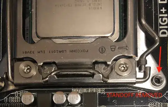

I had a similar thing happen to me using the same heatsink, a Cooler Master Hyper 212 EVO, with an x79 motherboard.
Just to clarify, I was installing the heatsink's standoffs onto the motherboard. I was able to get three installed, but the fourth one broke off. Here it is in the lower right:
Hyper 212 EVO Standoff Broken On Motherboard
Here is the thick part of the broken standoff:
Thick Part of Standoff
I had a couple of thoughts for removing the broken standoff:
  1. Use a cutting tool (dremel like) to create a channel in the broken standoff, suitable for removing the standoff with a flat blade screwdriver.
  2. Use a drill bit designed for removing screws with a stripped or broken head.
I opted for the second option as I was afraid of using a dremel to cut into the motherboard.
I put the drill bit into my drill and carefully placed the bit on top of the broken standoff. The drill bit is "left handed" meaning that it drills in the counter-clockwise direction.
I turned the drill bit slightly and the standoff started to come out. A bit more turning, and the standoff completely came out.
Here is a picture of the drill bit and standoff (out of the motherboard):
left-handed drill bit and standoff removed
Finally, here is the motherboard without the broken standoff:
motherboard, standoff removed
