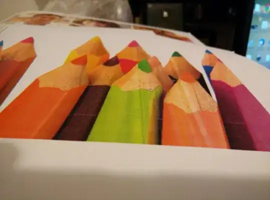

I have an old Lexmark x502n Laser Multifunction color printer.
It works perfectly, except it stripes everything I print with white lines:
enter image description here enter image description here enter image description here
I searched on internet and it seems that whenever something like this happens it means that you have to clean toners (their contacts) and sometimes you have to clean rollers. I did search in the printer utilities software and unfortunately there is no option to do it automatically.
Is that right? If not, what should I do, and how should I do it?

    I opened the printer and removed the photodeveloper cartridge, as described in the manual. It is full of stripes, in the exact same points where the printing has white stripes, so I really think that's the problem. Now, I think I will buy another printer, as just that cartridge costs around 300$... Thanks though! – Harlandraka Apr 17 '15 at 14:32
