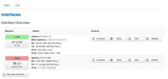

This is my setup : qBittorent 3.1.12 running on Linux Mint 17.1 I am using duckdns.org for DDNS through their Linux GUI My router is running on OpenWrt Chaos Calmer r45545.
What I have done so far: Enabled UPnP on the router and the redirects show up on the main page.

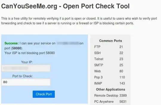

Even more confusing for me is that the port checking tool 'canyouseeme' is able to "see" the port.
