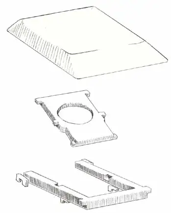

Laptop keyboards are indeed more complicated then regular ones. Regular ones are usually quite easy to pop out and push back. For laptops however, it's different, as you need to know how the mechanism is made underneath.
Here you can find information about how to do that for a Dell laptop:
http://www.wikihow.com/Pop-a-Key-Back-Onto-a-Dell-Laptop-Keyboard
Note that the mechanism may be a bit different for your own laptop, but keep in mind that it is based on same idea. You have usually two parts together under the actual key, and a part acting like a spring underneath it.
laptop keyboard key scissor mechanism
Knowing how it looks inside may help you, I hope. In general, keep in mind that you want to pop the top part out, not the two inside ones, and that this part is held usually on four corners, as described in the given link. Apply your effort to pop it from a corner. It will require a bit of effort, especially that you have to be careful to not actually break one of the inside parts.
In general, I would not recommend popping out all the keys from a keyboard to clean them. Do it for the really stuck and sticky ones, but it is not as trivial as a regular keyboard, as you can see.

  • +1/accepted just for the exploded diagram. Based on the keyboard I fixed, the fact that your link is for a Dell and broken laptops I've seen in the past, I think this is a standard design. – Pops Jan 06 '10 at 18:35
  • It does appear relatively standard. I've seen the same (or at least very similar) design on Toshiba and Lenovo laptops. Make sure any replacement parts you source are for the keyboard you have though - there are likely to be small variances between some models. – David Spillett Mar 08 '10 at 09:45
