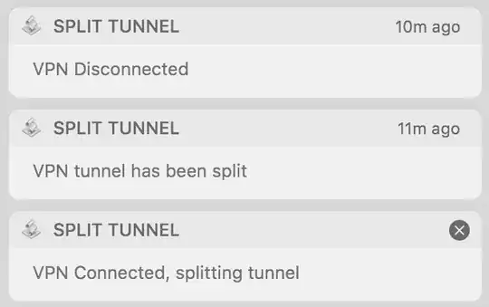

I wanted a native 'app' that I can run at logon (and keep running/hidden) to enable Split Tunnel routing, similar to a function of Locamatic. Perhaps I'll fork Locamatic at some point and play with it. I may also upload this AppleScript to Github. I didn't want to mess with a daemon as this answer suggests.
This script assumes VPN has default VPN (Cisco IPSec) name and VPN route is 10.10.10.1/22 > 10.10.20.10. These will need to be changed/additional routes added. Run terminal > netstat -rn when VPN is connected (prior to enabling this script) to see VPN-added routes.
This script also generates growl-style notifications in Notification Center :)
I ran into some issues with Mark E. Haase's answer as my Cisco VPN modifies the existing gateway from a UCSc to a UGScI (en0 interface specific) route and adds the VPN gateway as a UCS route, necessitating the deletion of two default gateways and adding back the original UGSc default gateway
Thank goodness for StackExchange/google, this is my first AppleScript and I wouldn't have been able to put it together without a few hours of googling.
Suggestions/corrections/optimizations welcome!
AppleScript (GitHubGist):

on idle
    set status to do shell script "scutil --nc status "VPN (Cisco IPSec)" | sed -n 1p"
    # do shell script "scutil --nc start "VPN (Cisco IPSec)"
    if status is "Connected" then
        if done is not 1 then
            display notification "VPN Connected, splitting tunnel"
            set gateway to do shell script "( netstat -rn | awk '/default/ {if ( index($6, \"en\") > 0 ){print $2} }' ) # gets non-VPN default gateway"
            do shell script "sudo route delete default" # deletes VPN-assigned global (UCS) default gateway
            do shell script "sudo route delete default -ifscope en0" # deletes en0 interface-specific (UGScI) LOCAL non-vpn gateway that prevents it being re-added as global default gateway
            do shell script "sudo route add default " & gateway # re-adds LOCAL non-vpn gateway (from get command above) as global default gateway
            do shell script "sudo route add 10.10.10.1/22 10.10.20.10" # adds VPN route
            display notification "VPN tunnel has been split"
            set done to 1
        end if
    else
        if done is not 2 then
            display notification "VPN Disconnected"
            set done to 2
        end if
    end if
    return 5
end idle

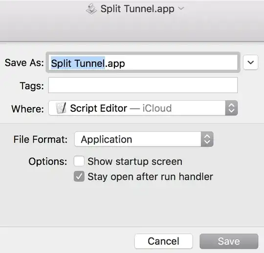

save as an app:
Split Tunnel app save settings
right click>show package contents, add the following to info.plist (this hides the app icon from dock, necessitating the use of Activity Monitor or terminal > pkill -f 'Split Tunnel' to quit the app, omit if you WANT a dock icon:

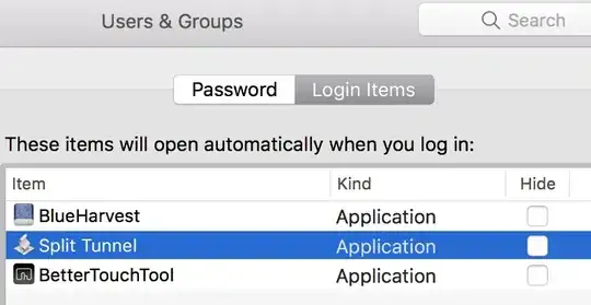

create a new one-line routeNOPASSWD file (no extension) using the following code EXACTLY (this can prevent sudo access if done incorrectly, google visudo for more info - this allows the sudo commands in the AppleScript to run WITHOUT a password prompt, omit if you WANT a password prompt when the routing table needs to be changed):
%admin ALL = (ALL) NOPASSWD: /sbin/route
copy this file to /etc/sudoers.d
run the following commands in terminal (second command will prompt for password - this allows the sudo route commands in the AppleScript to run WITHOUT prompting for password, omit if a password prompt is desired when script is changing routing table)
chmod 440 /private/etc/sudoers.d/routeNOPASSWD
sudo chown root /private/etc/sudoers.d/routeNOPASSWD
finally add the app to System Prefs > Users and Groups > login items
Split Tunnel Login Item
