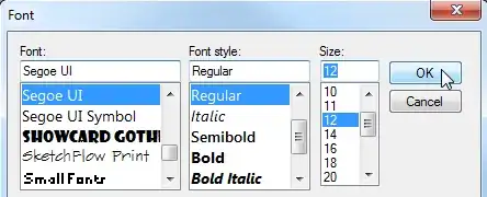

I'm having problems with graphics that get "stuck" in Windows 7, usually when selecting an item in a menu. See screenshot.
It's removed if I change the resoultion of the screen.
How can I fix this?
alt text
    I think you may be able to right-click on the Desktop and choose "Refresh" to clear it. – Jared Harley Jan 07 '10 at 04:15
