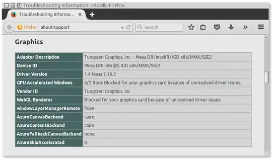

Well, I wanted to try to check out WebGL on Firefox (v38.0.5 on Linux); and I realized that in about:config, webgl.osmesalib was set to /usr/lib/libOSMesa.so.6, while about:support claimed:
Graphics
Adapter Description: Tungsten Graphics, Inc -- Mesa DRI Intel(R) IGD GEM 20100330 DEVELOPMENT x86/MMX/SSE2
Device ID: Mesa DRI Intel(R) IGD GEM 20100330 DEVELOPMENT x86/MMX/SSE2
Driver Version: 1.4 Mesa 7.10.2
GPU Accelerated Windows: 0/1 Basic Blocked for your graphics card because of unresolved driver issues.
Vendor ID: Tungsten Graphics, Inc
WebGL Renderer: Blocked for your graphics card because of unresolved driver issues.
windowLayerManagerRemote: false
AzureCanvasBackend: cairo
AzureContentBackend: cairo
AzureFallbackCanvasBackend: none
AzureSkiaAccelerated: 0

... and still - I get this in about:support, the same as above:
So, it's still referring to Mesa 7.10.2, regardless - and I have no idea why?

Ok, I think I understand now: as per Enable OpenGL 2.0 and WebGL for Intel GMA3150 in Ubuntu, what this new Firefox sees as a Graphics driver, is not some specific file version, but that which is reported by glxinfo:
$ glxinfo | grep -i "OpenGL version"
flushing GPU caches before/after each draw call
OpenGL version string: 1.4 Mesa 7.10.2
Then I configured again with a prefix /usr (otherwise the default is /usr/local), which is where Ubuntu Natty wants these stored; and did install:
./configure --enable-gl-osmesa --prefix=/usr
sudo make install
And then, just for a while, glxinfo returned 7.10.3, which is what Firefox would have seen; but for one I ran out of disk space; and for another, now after reboot I get:

... except, not even this is good enough for this Firefox:
Ah, well...
