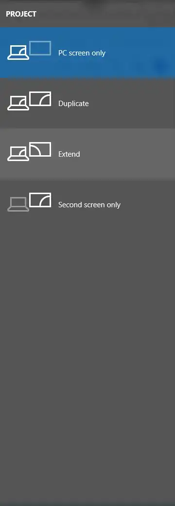

On Windows 10 second display can be added by pressing Win+P and selecting needed option in the appeared panel at the right side of the desktop.
See screenshot
I have only one real display, but I can add another one using Win+P.
fixer1234
